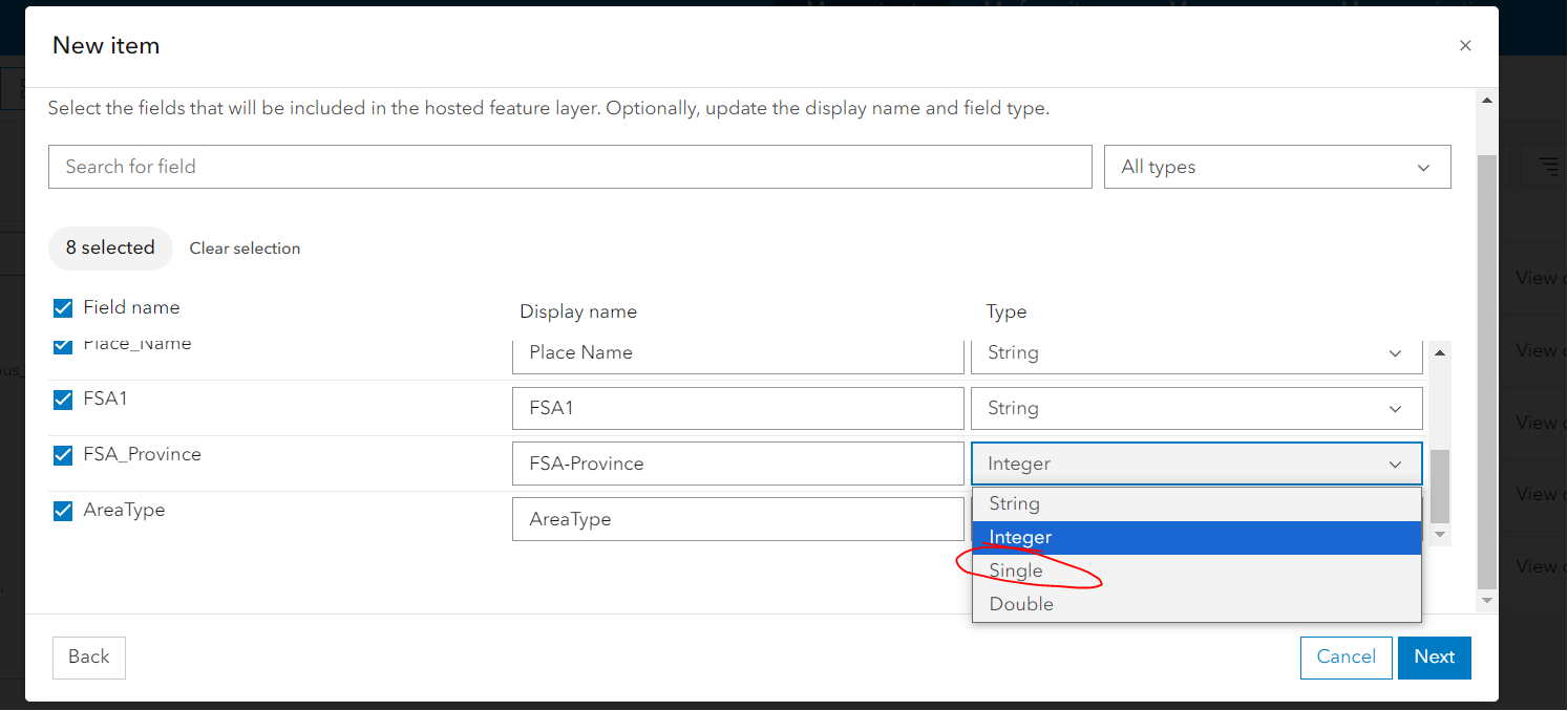

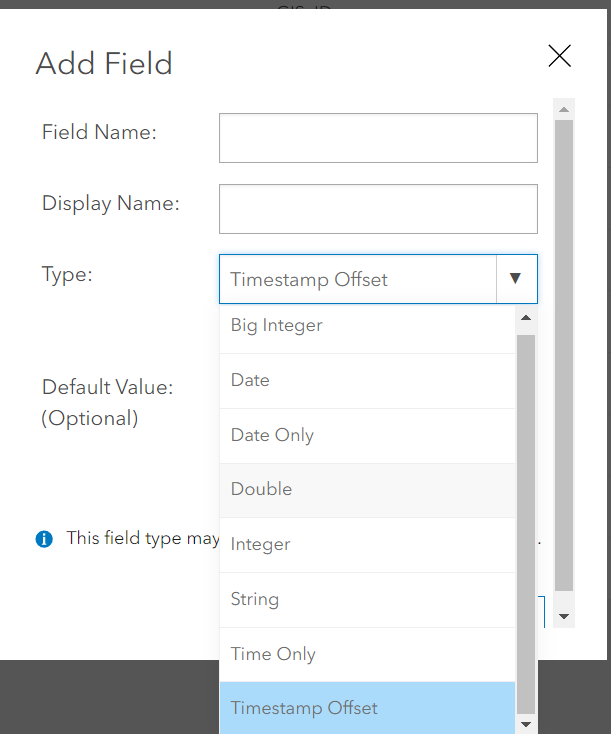

Then I went into a layer to see if I could add a new field with the 'single' data type, and it was not an option in the drop down menu of data types. When adding a new csv hosted feature layer however, it is possible to designate a field as a single type. Again, seems inconsistent.
I am just wondering if these inconsistencies are intentional or if there is a reason for them that I am missing.

Yeah its seems intentional. If you want to add a single data type, you need to use the add definition call in the rest api as it stands. Hopefully that changes in the future as it does not make any sense.
