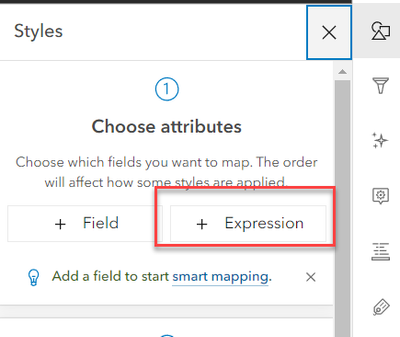

VanessaSimps
you can do this in the Map Viewer.  Just be aware that sometime the arcade profile may differ between Pro and Map Viewer symbology.
https://developers.arcgis.com/arcade/profiles/visualization/
