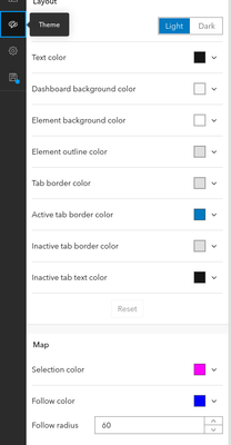

The color is in the dashboard theme settings:
The size, I don't think you can control without doing something really hacky, like buffering the point feature in a Data Expression or something.

Thank you. In the past on other maps the flash was a round dot, now its a rectangle and small and is drivng me  nuts. I found the color change, that worked.

I'm not seeing any options at all to edit Map colors in my Dashboard... is this something that may have moved or gotten phased out in a recent update?
(snapshot attached)
GretchenFolse
UPDATE: Found another way to do this just by changing the "Accent color" in the Custom theme settings (because that also seems to dictate the color of the flashing halo around the point when it's selected) and by poking around in the ArcGIS Online Assistant and making some edits in the JSON.
