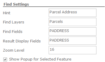

I'm looking for any specific documentation or help on the Find Settings in the Finder app in ArcGIS Online. I have a layer named Parcels in the web app, but the Finder app can't seem to read it for the search.
Settings in Finder App

Hi Lee,
Finder can't search against layers that are nested in the TOC of the web map. There's documentation on this here:
Configure Finder app - Get Started | ArcGIS for Local Government
Specifically, check out the info for step 2 under Find Settings.
You can search against the Parcels layer if you add it individually to the web map (REST URL should end in a layer index number).
-Allison

LeeAllen
Thank you, that is exactly what I was looking for, but just could not find it.
