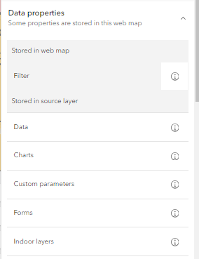

Somehow, this source layer has had a filter applied to it, which filters out a large segment of my data. I can remove this filter within the webmap, which lets me see all of the data as expected. However, doing so indicates that this filter setting is stored only in the webmap. If I "reset to source layer properties", the filter comes back.

It's possible that the filter is saved in the layer.
Item details, Visualization tab, check for filters on the layers, then if you remove them, make sure to save the changes.

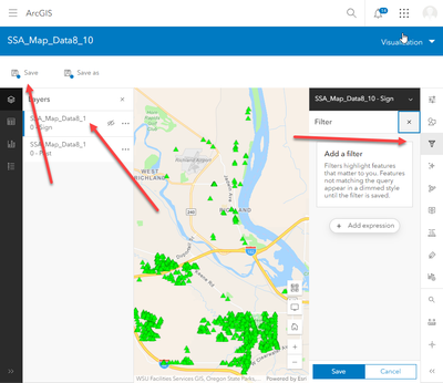

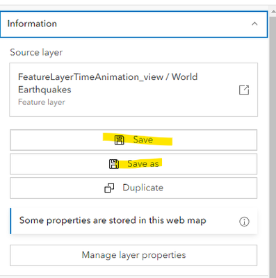

Esri Notable Contributor
You can also remove the filter from the map you are viewing it in and save that change back to the item by clicking Save (if its associated to an existing item) or clicking Save As will create a new item that will not have the filter applied and you can reuse that across other apps and maps.
