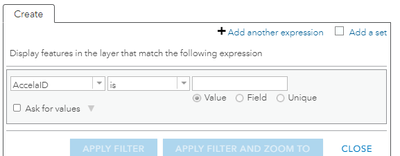

Looking to filter a Feature Layer to show only features with null / no data values from a text field, but cannot figure out how to do so.
Basically trying to create a map that will be used by a field editor, showing them which features need to have data entered.  Once they add a value to the field, it will then disappear from the map.  This should be easy, right?

In the 'is' dropdown in the middle, there should be an 'is blank' option.

I'm using the Classic Map Viewer, so IS is the only applicable operator.  I tried every combination of NULL, <NULL>, etc. and unfortunately that doesn't work.
sgambrel_Bouldercounty
A ha!  That worked!  Thanks, I did not see the "Is Blank" down the list - I really figured that "Is" was going to be the operator.  Thank you.
