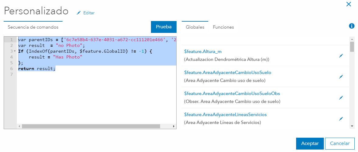

Arcade allows you to create an expression to symbolize your data. If in your webmap you go into the symbology of the layer, you can scroll down on the field to use until you see "new expression" at the bottom. This will open the expression window, where you could enter the expression. For example something like this:
var parentIDs = ['6c7e58b4-637e-4031-a672-cc111201e466', '2e49394e-aa32-45d4-b2ab-6a83f7de5d3c', 'a8180679-33a3-4a15-b5a5-c18b6c2fda19', '6ad52c32-7436-49c1-93dd-538b625da159', '40571e30-81f8-4829-8cbf-8e9d3860ad5b'];
var result  = "no Photo";
If (IndexOf(parentIDs, $feature.GlobalID) != -1) {
    result = "Has Photo"
return result;‍‍‍‍‍‍‍‍‍‍‍
The parentIDs where extracted from the REST service using the QueryAttachements task and using some Python to extract the values into an array. If the data is dynamic (still being edited) it might be possible to use a REST query in the Arcade expression, but this might kill the performance...

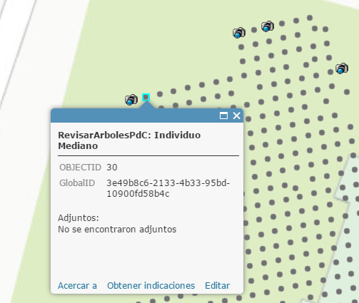

And you will see that when clicking on a grey (no Photo) point it will return this:
Clicking in a point with the photo icon, will show the attachments:
