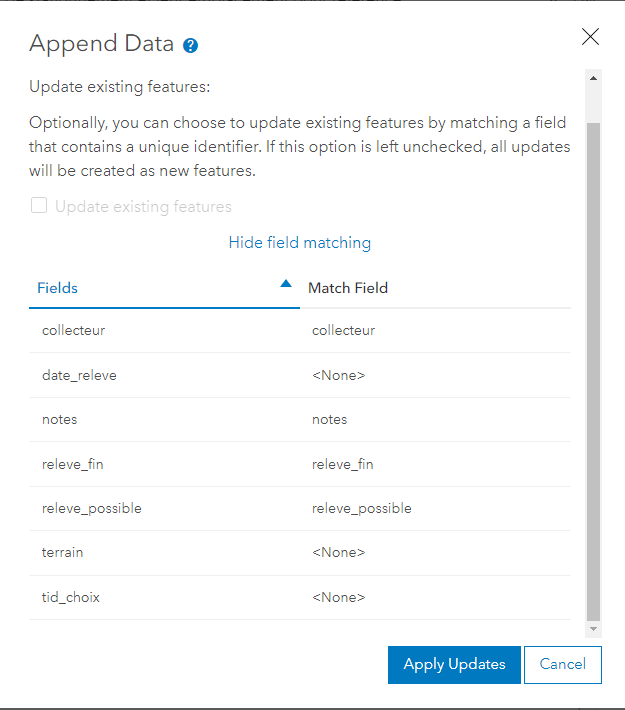

The table contains the exact same field names, then I extract only the rows I want and try to append it with the update/append data option in AGOL. However, there is a popup complaining that some fields do not match:
How to ensure AGOL recognizes the fields?

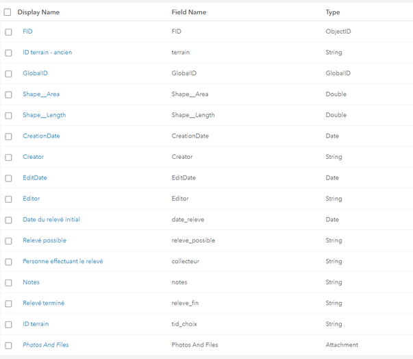

Here is a screenshot of the extracted table fields

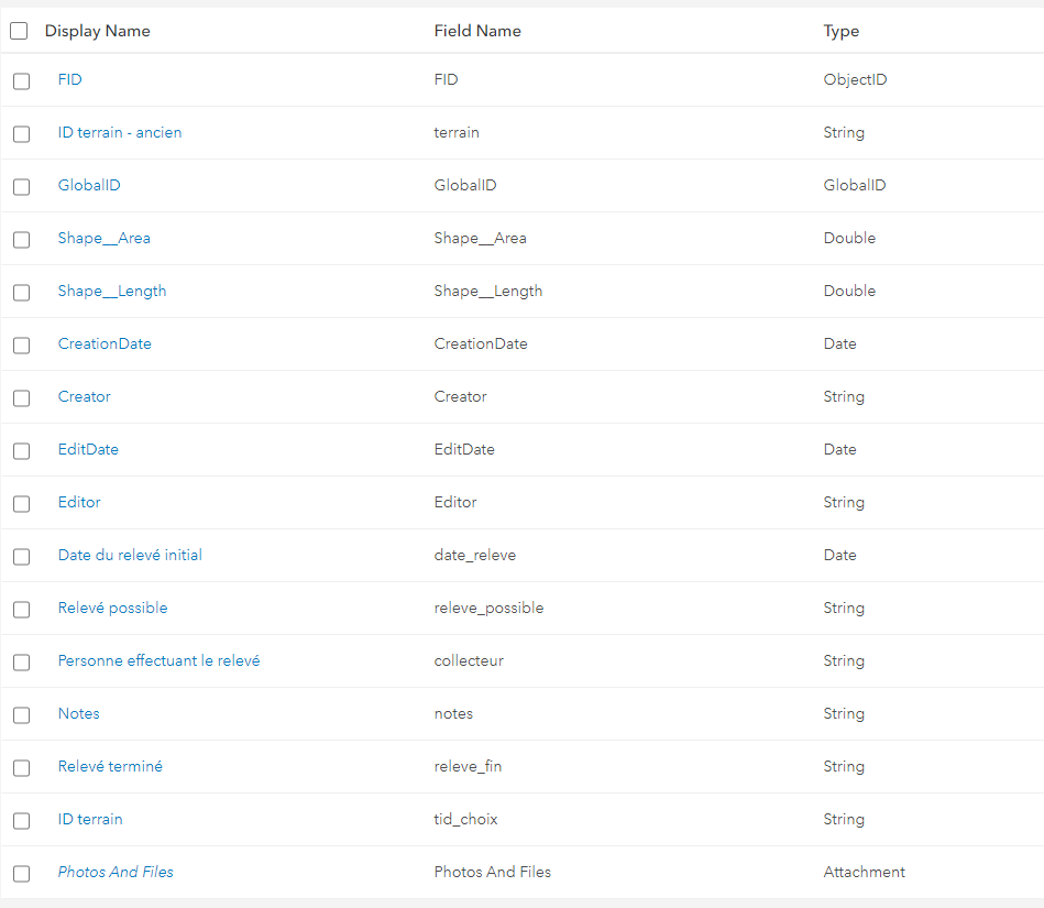

and the fields in the hosted feature layer
Only difference is "geom" in the original table and "Photos And Files" in AGOL. Could this cause a problem?

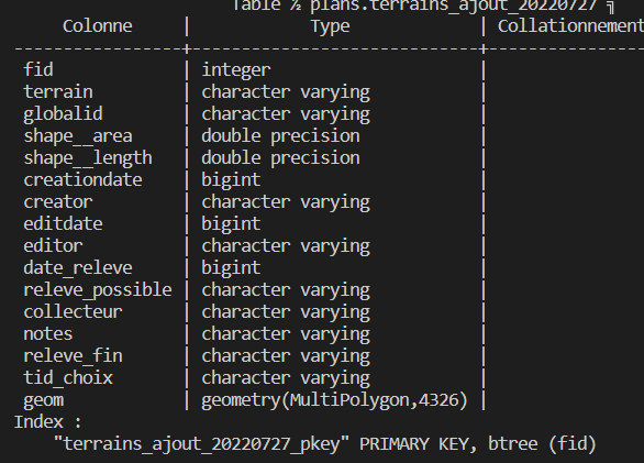

I retrieved the layer in question (which was originally uploaded to AGOL and updated with Field Maps) with the REST API (endpoint query) and inserted it in PostgreSQL with PostGIS enabled. I then drew some new features (polygons) while connected to this table in QGIS. I did not use ArcGIS Pro.
I tried then converting the new features (rows) to a zipped shapefile and a geojson, and both did not give a perfect match when trying to append as shown in the capture in my original post.
I have not tested this method on other datasets.
Concerning your question : Does the dialogue give you the ability to manually match the fields? The answer is no and that is definitely a big problem! I could not reassign the Match Field to other field or select a field for the ones that had no match. I guess if I could have changed this, I would not have posted this question 🙂
