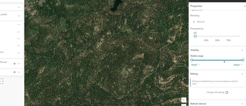

I'm running into an issue and am wondering if this is a bug or there's a weird catch I'm not getting here.  I've created a webmap with several empty feature layers imported from ArcPro.  All of the layers are editable except for one, despite the fact that I have enabled editing in the settings for each one.  I was randomly running into issues saving the form when I was building it, but those issues seemed to resolve themselves when I enabled editing from the settings panel of the feature layer.  Now when I try to uncheck and reselect the enable editing settings, I get another error message that the saved changes cannot be completed.  Maybe I didn't check a box before sharing from ArcPro?  I get this error message when editing the form in designer (screenshot attached):
Layer editing
Editing is disabled on one or more layers. However, your privileges allow you to edit any layer in the map.

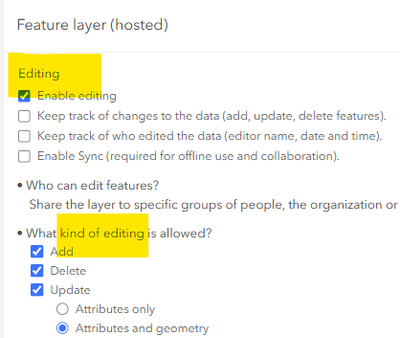

Check the editability of the layer in 2 places:
1. The Settings tab on the Item Details Page for the Layer. Also check what types of editing are allowed. If editing is restricted (to Add only for instance), then the alert you see is expected.
2. The Layer Properties in the map
As the layer owner you have privileges to edit the layer whether editing is enabled, restricted, or not enabled at all. The alert is to inform you that your privileges supercede the settings. It is not an error.

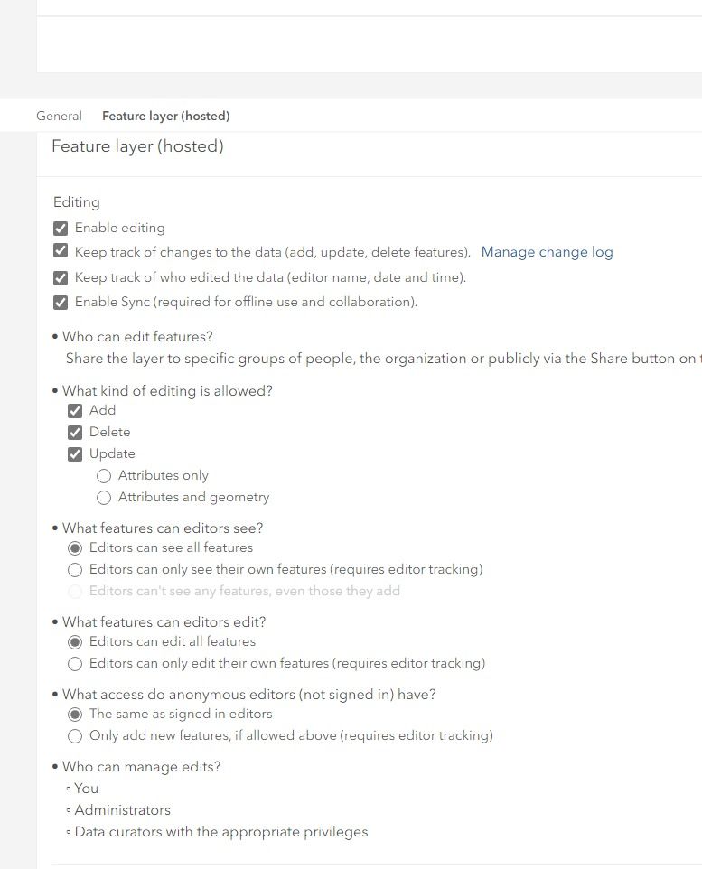

Thanks for the input so far folks.  Here's what that screenshot looks like for me, along with the other places mentioned:
As you can see, I have enabled editing but am still getting this error.
