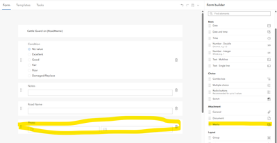

Hello @ajones , I am encountering the same issue when trying to add a Media attachment to a form. It is giving me zero errors in the field maps designer and allows me to edit within the Map Viewer and Edit widget in experience builder, but when I try to create a new feature in the Field Maps app it shows the layer as "The form contains unsupported data". The feature layer is brand new, created in AGOL and it only contains 4 text fields. Attachments are enabled. I have your suggestion enabled as well. If I remove the attachment field from the form, it all works perfectly. But I was excited to use this new feature to encourage field photos. Do you know what else I should try?
