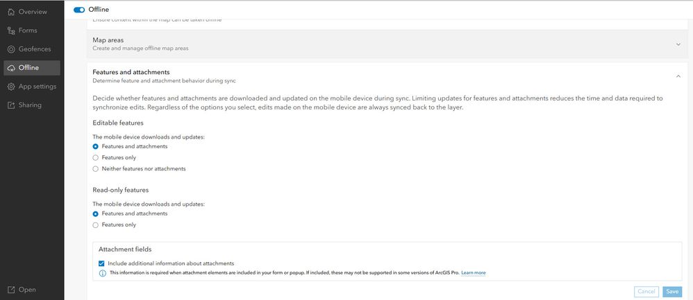

ajones
by Esri Contributor
Hello!
You should be able to resolve this issue by enabling "Include additional information about attachments" in the Features and attachments section under the Offline tab in Field Maps Web Designer. Afterward, ensure that the content is refreshed via the Content section or through the warning that appears.
- Annekah
