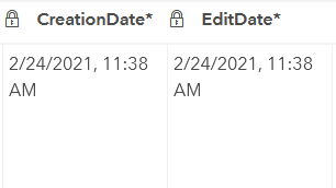

Technical Problem: Using Arcade Field Calculation as per Calculate field values—ArcGIS Online Help | Documentation on an ArcGIS Online hosted feature layer updated the Creator and Creation Date fields.
We expected it to update the Editor and Edit Date - but since we did not create or overwrite fields, we did not expect it to change the creation fields. This is problematic because we now lost the history of who created each point.

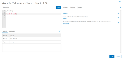

I've tested this is in Firefox and Edge with ANY Arcade expression in a string field, even a simple one like = ' '. I've tested with both points and line features created using ArcGIS Online hosted feature layers.

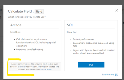

In this post, @pmckinney  mentions "Because we have editor tracking set, we are not able to use Arcade expressions" when discussing the use of SQL in AGOL field calculations.
Is this correct?
@XanderBakker
That should just about do it....
AlixVezina
@JoeBorgione That's right, if either of these options are enabled, you will not be able to run an Arcade calculation (SQL will still work though).
