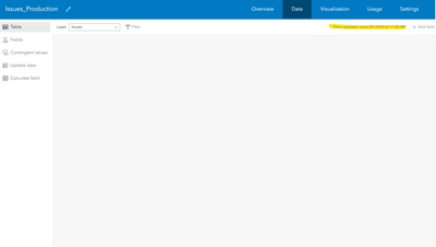

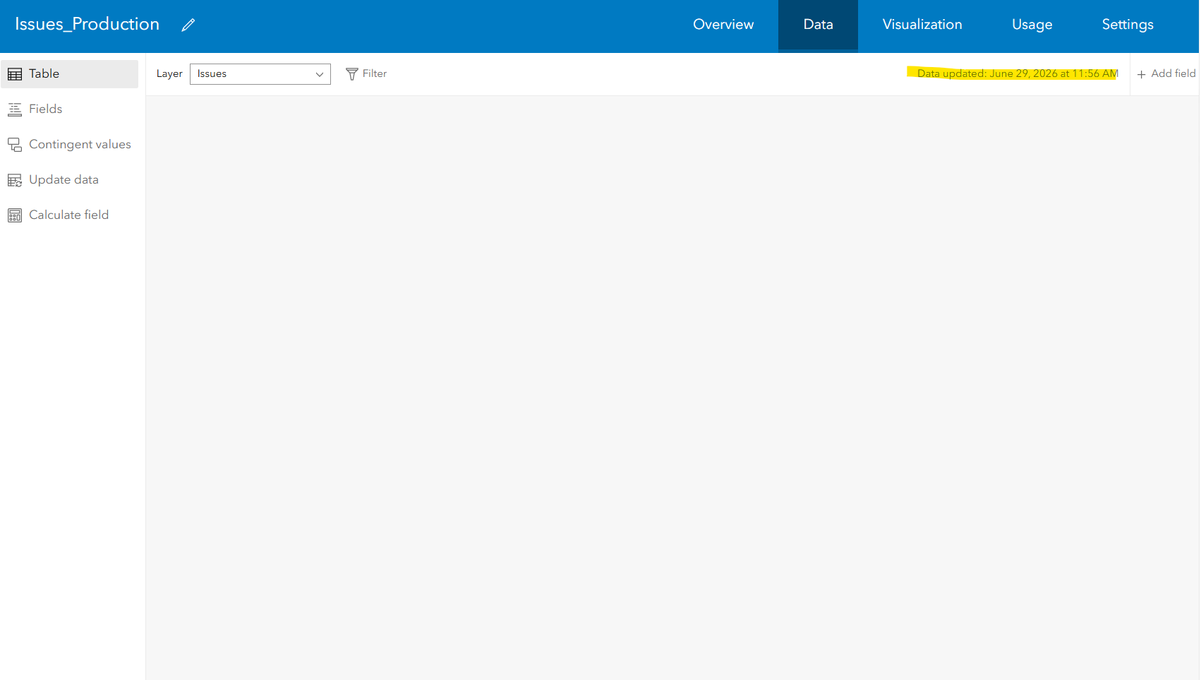

After the update on Thursday, one of our feature layers is no longer providing its table on the data page. The page remains blank, though it does say the layer is being updated when data is provided to it through a Web App. Our views based on this layer are also functioning, but we need this layer to power a task that provides the gathered data to another website. Since the table has become "unviewable", the task we are running cannot extract the data. We're currently at a loss on what to do and it is leaving one of our applications dead in the water for our business.

  • In visualization, the table comes up but it is not up to date and stopped at 6/10 (unsure why). Plenty of new data has come in since and is viewable in our views built off the layer.
