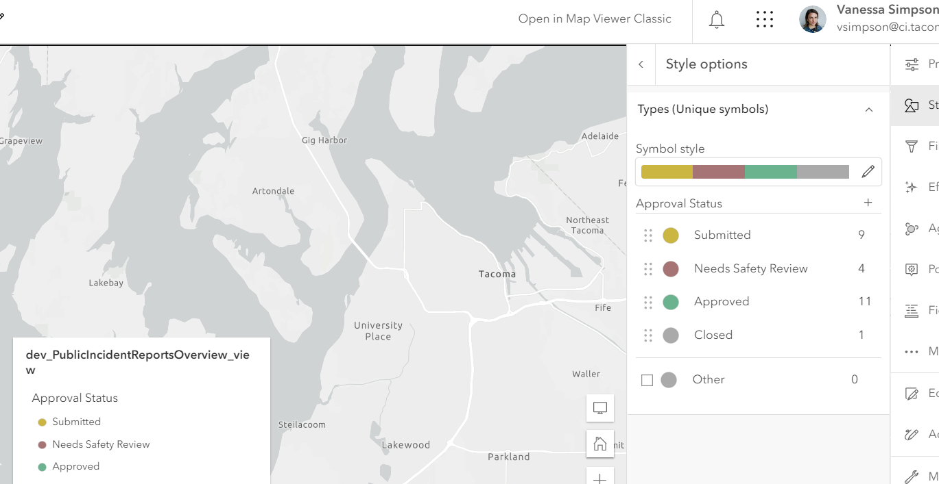

I created several feature layer views off a hosted feature layer last week. I had these all added to a web map and configured with pop-ups etc. I could see everything just fine before leaving last week for the weekend. My end users notified me today that nothing was showing up in the map/app.

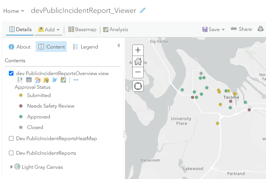

I did some testing, and even rebuilt the view layers from scratch- but these layers won't show up in the map viewer. I can see the symbology count and the data in the table, but nothing on the map. On a whim, I brought the same layers into Map Viewer Classic and everything shows up as expected.

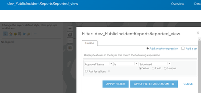

Two things I did notice is that when I click on the "visualization" tab, that the data opens in the classic viewer style map and not in the new map viewer style map. it feels like all of the data is somehow stuck in classic??
There is an Arcade expression/filter set on the view layers that I can't access or change. it is setting them with the Approval Status of Submitted and I can't get rid of it.

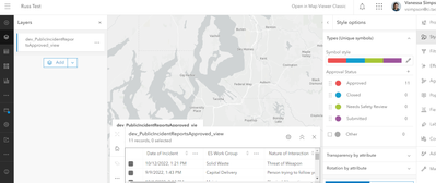

Thanks! I got it and see an error in the dev console ( esri.views.2d.layers.features.sources.SnapshotFeatureSource] mapview-snapshot-source Encountered and error when downloading feature snapshot )
Taking a look to see what could be causing this. Do you have the uploaded file available (SD, Fgdb etc) that created the layer originally?

VanessaSimps
I am still not seeing the dots on the map??? But- the data is in the table and the symbology is being counted??? This is what I was seeing prior.
