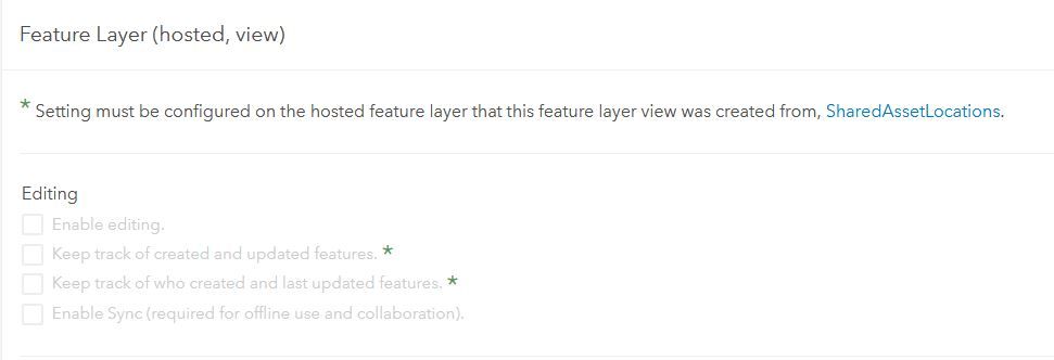

I have a map put together and symbolized using the new Map Viewer that contains an editable hosted feature layer called 'SharedAssetLocations' (sync enabled) which has several related tables . I created several different view layers that each represent the hosted feature layer joined with one of its related tables.  The view layers were generated using the 'Join Features' analysis option from the classic Map Viewer.
The item pages for the hosted view layers have the edit and sync options greyed out with a note saying that the * settings must be configured on the hosted feature layer the view was created from; sync is not one of the starred options.  Does that mean the hosted views do not inherit the sync option from the original hosted feature layer?

There is a known limitation where Hosted Feature Layer Views created from the Map Viewer Classic Join Features analysis tool are not supported for offline use.
Standard Hosted Feature Layer Views support offline usage. Synchronization needs to be enabled on the parent layer first and then the view.
You can create a duplicate layer by unchecking the option to store the output of Join Features as a Hosted Feature Layer View, or run the analysis tools in ArcGIS Pro to reach the end result on the input layer.
