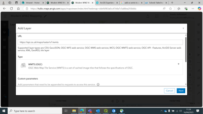

LouisJohnston
Hi - I have been having an awful time uploading a WMTS feed from OS onto Arcgis online. THANK you for this! Using the key as a separate attribute works!
