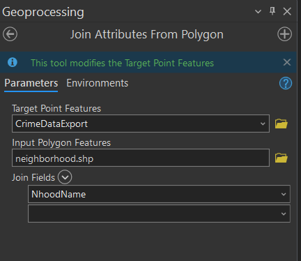

From a query layer I get new data by selecting "Display X/Y" to CrimeDataExport layer in pro.
Then I use "Join Attributes from Polygon" 3 times to add 3 columns to the CrimeDataExport layer. Neighborhood, NPU, and City Council district.
All three only take a few seconds in Arc Pro. Once they are done I run "Import Incident" and it updates the online feature correctly. No matter how many times I run this in Arc Pro it works correctly.
Starting from Display X/Y down to the Import Incidents I create an individual scheduled task and give each a 5 minute buffer before running the next step. The problem is with the second step, Join Attributes from Poly when adding the Neighborhood column. The task will run forever if I let it. The other Joins run for about 30-45 seconds.

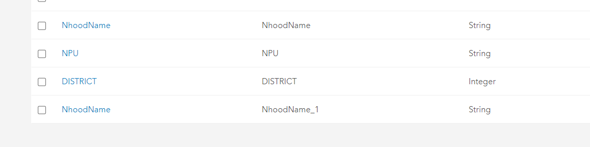

For some reason every time I run the Join for the neighborhood it adds an extra column only to the online feature. The local crime data layer does not get these extra columns.
Does anyone have an idea why this would be happening?

I believe I have solved my problem.
The local layer and the web feature layer used the same name CrimeDataExport. I assumed that when I ran the join poly for neighborhood it would always try to update the web feature layer instead of the local layer. No matter which I selected. So... I changed the local layer name to CrimeDataExportLocal and everything seems to be working fine. So far, it has successfully run 3 automated updates without a problem.
