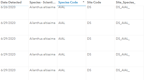

I have created a feature layer in ArcGIS online to manage invasive plant species populations in our Parks, that I plan on using for detection/treatment tracking purposes and for field work using Field Maps. I was wondering if there is an expression to designate intentional unique identifiers to each population (feature). I have a park code for each, and a species code for each that I calculated in the attribute table using Arcade for all features.  I would like to combine these fields and also populate a number in sequence number by date.
For example, at our Dam Site Park (DS) we have multiple Ailanthus altissima (AIAL) populations. I would like for to create a field expression that will assign unique identifiers: DS_AIAL_1, DS_AIAL_2, DS_AIAL_3, etc, with numbers in sequence ordered by Date Detected (see fields below).
