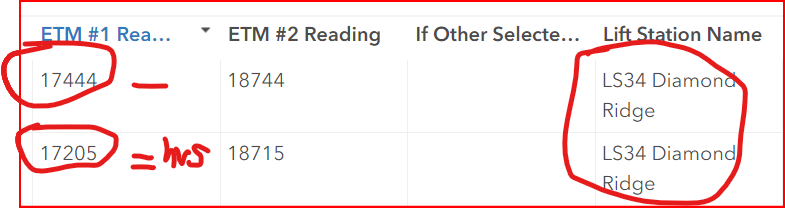

Hi I am looking to create a new field from an expression. I have a survey123 form feature layer where I am collecting pump hour readings twice a week and I want to calculate run hours from the current reading  from the previous reading. Does anyone have a script for this? I am struggling to get the difference between a current date reading and a previous date reading. HELP???
Thanks!
Tom

TomKukitz
Deactivated User
Thank you, I really appreciate it!
I get that time diff part, but I need to display the etmhours field attribute. So in essence I am get hours from one date and subtract from another date. It would be curretm - prevetm. Current date would be the last and most current date, subtracted from the second last current date or the previous to current. I hope I didn't totally confuse you now???!!! Any ideas on how to accomplish this? I am trying to avoid writing a 10 page script as well. Things take forever with Arcade, I so miss attribute assistant, so much easier in VB.
Any input much appreciated!
