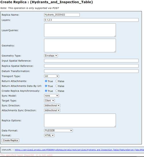

When I export I have multiple layers shown in that section, I will upload a screenshot of my setup:
You may notice, that across the bottom is says layerid: 1 is not valid. It seems like this may be part of my issue for my two related tables to be exporting within the FGDB.

Oh, interesting. What type of layer is layerID1? Can you also share a screenshot of what the REST endpoint looks like for the feature service?

I am thinking that since there is only one layer, it may now know what to reference. Here are the tables contained within this feature dataset. The multiple GBD_ServiceItems are from previous FGDB exports when the data was smaller and it worked through this screen.
Are you able to navigate me to the REST endpoint section? Thanks!

Scratch that, I got it to work!
When I was sending the screenshots of my layers I realized what the IDs actually were, and it worked once I fixed them. Thanks for your help!

Ok yup, that's exactly the info I wanted to see in your screenshot. Just needed to reference 0, 3, 5, 6, 10 instead of 0, 1, 2, 3
