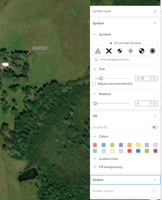

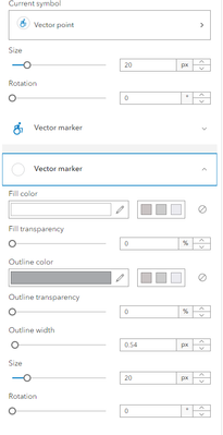

Next Issue - With these web style symbols I have a halo on them in ArcGIS Pro.  That does not come through in AGOL/web map, nor can I add an outline (halo) to this symbol in AGOL/web map?
What am I missing here?

Going to need to see the style to check that out. The main thing coming in the next release in a few weeks is exposing the symbol layers accurately vs. the current released styler has a very basic symbol layer control.
