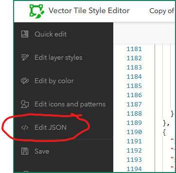

Copy the JSON text from the Edit JSON tab in Vector Tile Style Editor:

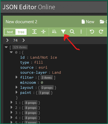

Paste it into https://jsoneditoronline.org/ :
Click on the filter icon to isolate desired layers

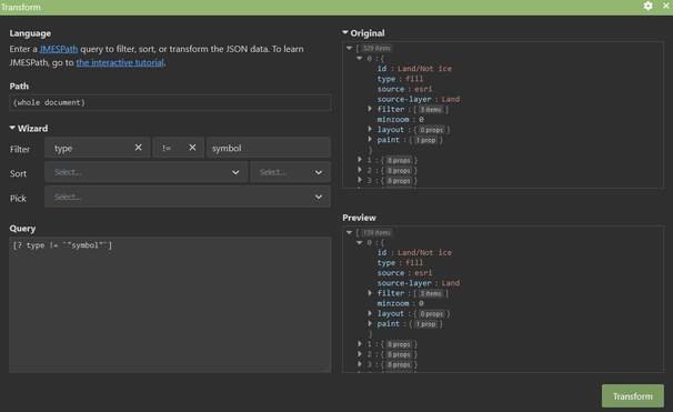

With the World Street Map, there are only three layer types: fill, line, and symbol
(this can be verified with the query [*] | sort_by(@, &type) | [*].type for other basemaps)
we want just fill and line, so in the wizard, filter -> type | operator -> != (is not equal to) | filter text -> symbol
This takes our 329 layers down to just 139 with no text or icons.
**if there happen to be other types, the query for just fill OR line is  [? type == `"line"` || type == `"fill"`]
Hit 'Transform'. type CTRL + A to select all text, replace the json text in the vector style editor, and click the Update button at the top

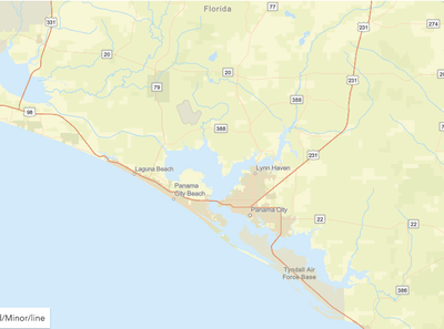

This takes our basemap from this:

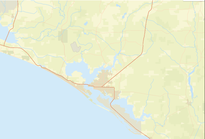

 to this:
