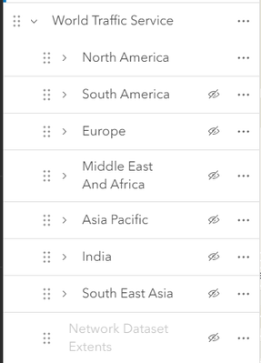

I was receiving the same error while attempting to save a Webmap using the World Traffic layer from the living atlas as well. It was happening whenever I removed any of the traffic datasets I didn't need. I re-added the layer, turned the visibility off for un-needed traffic data, but did not remove any, and it saved just fine. I hope this helps🙂
