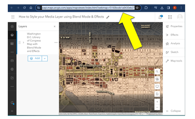

In Map Viewer there currently isn't a shortcut link. But you can grab the URL you see at top and share it with others like this:
https://onlinelabs.maps.arcgis.com/apps/mapviewer/index.html?webmap=a55d849e43d04740845bb2aeea340510
You'll need to share it appropriately for your audience and if public and there is subscriber content in your map then viewers will be prompted to authenticate.

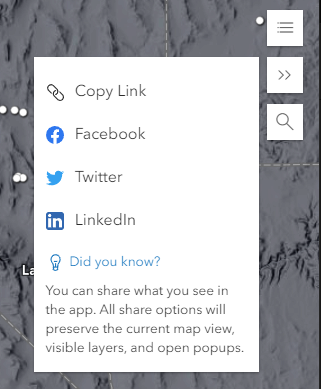

A better way to share a map is to use Instant Apps like Basic or Media to make a simple app. That will also handle any subscriber content. Those apps offer share tools which are configurable

In case that is still Greek to you....with your map open, you can copy the text here:
then paste that as the link to the map.
