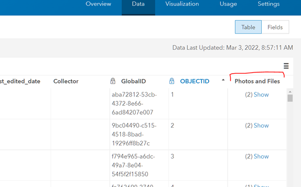

So, if your feature has attachments, you can check the data tab of the Item Details page to see if they're there.
If you just have a text field in the table with a URL to an image, that's not the same as an attachment.

Silly question, but...just because attachments are enabled doesn't necessarily mean there are any attached to the feature. Are you sure there are actually attachments added to the layer?

How do I make sure that there are attachments attached to the feature. As of right now, I have a field in the data table with a link to an image. I want to use that image as the attachment for use in the Attachment Viewer application.
