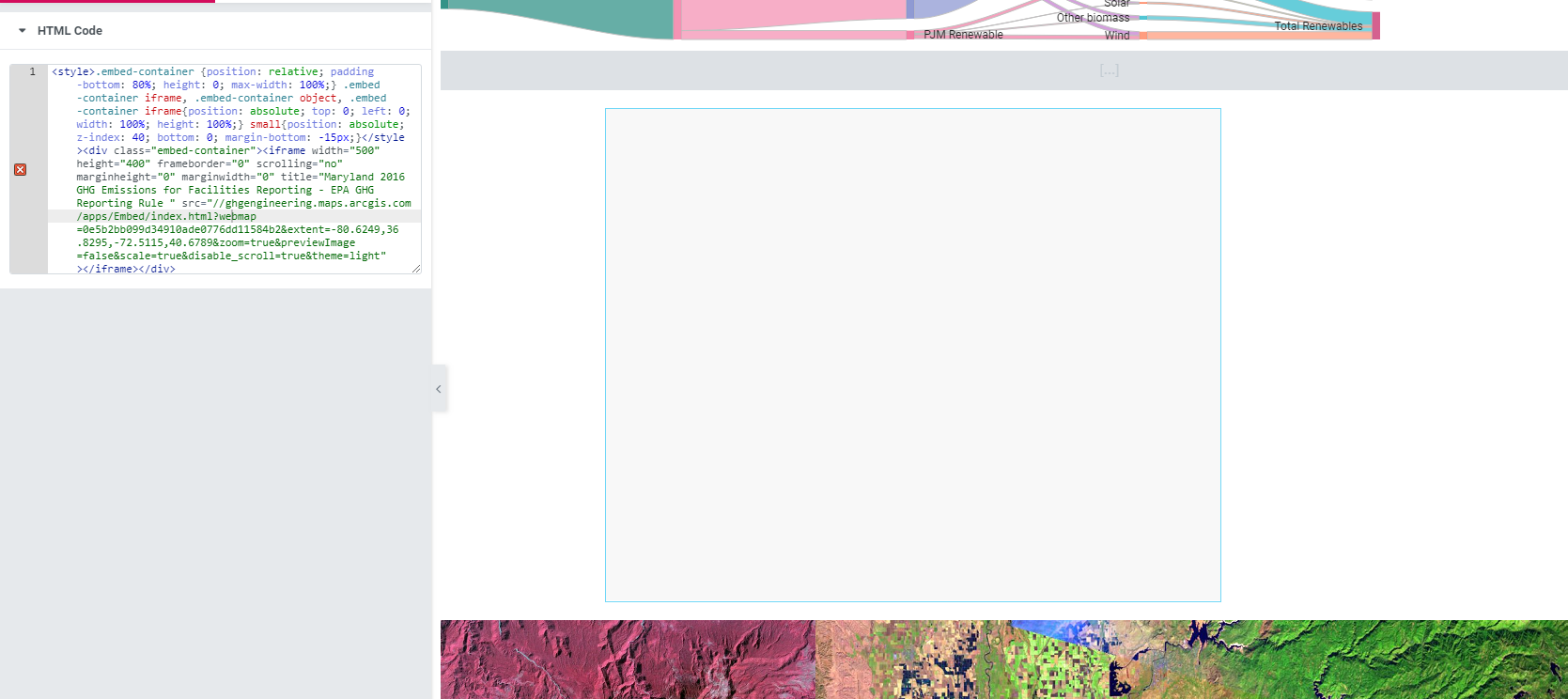

Steve just fyi : screenshot from my side...of my website
Did your suggestions-still not working, the very strange thing was that the embedded code for the webmap was working fine and then like 2-3 weeks ago the space where the web map should be appeared like a grey rectangle instead of the web published map. The strangest is that I have a web app in the same website using the same map and it works fine. Maybe, well mpst likely, Im missing something...
