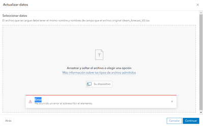

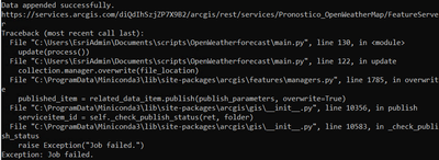

Hi everyone. I am trying to update/overwrite a hosted feature layer in ArcGIS Online through Python using 'manager.overwrite' but it doesn't work, I even tried to overwrite it manually with the source '.csv' file without success, apparently the element has some kind of error or lock that prevents to perform this action. It also does not work if I run the task several times.
The errors are shown below:
Note 1: The element works properly for months, after a while this happens. This is the second time it happens.
Note 2: It also does not work if I enable the edit option in advanced options of the element.

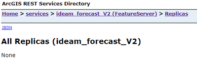

Note 3: This element also has no pending replicas.

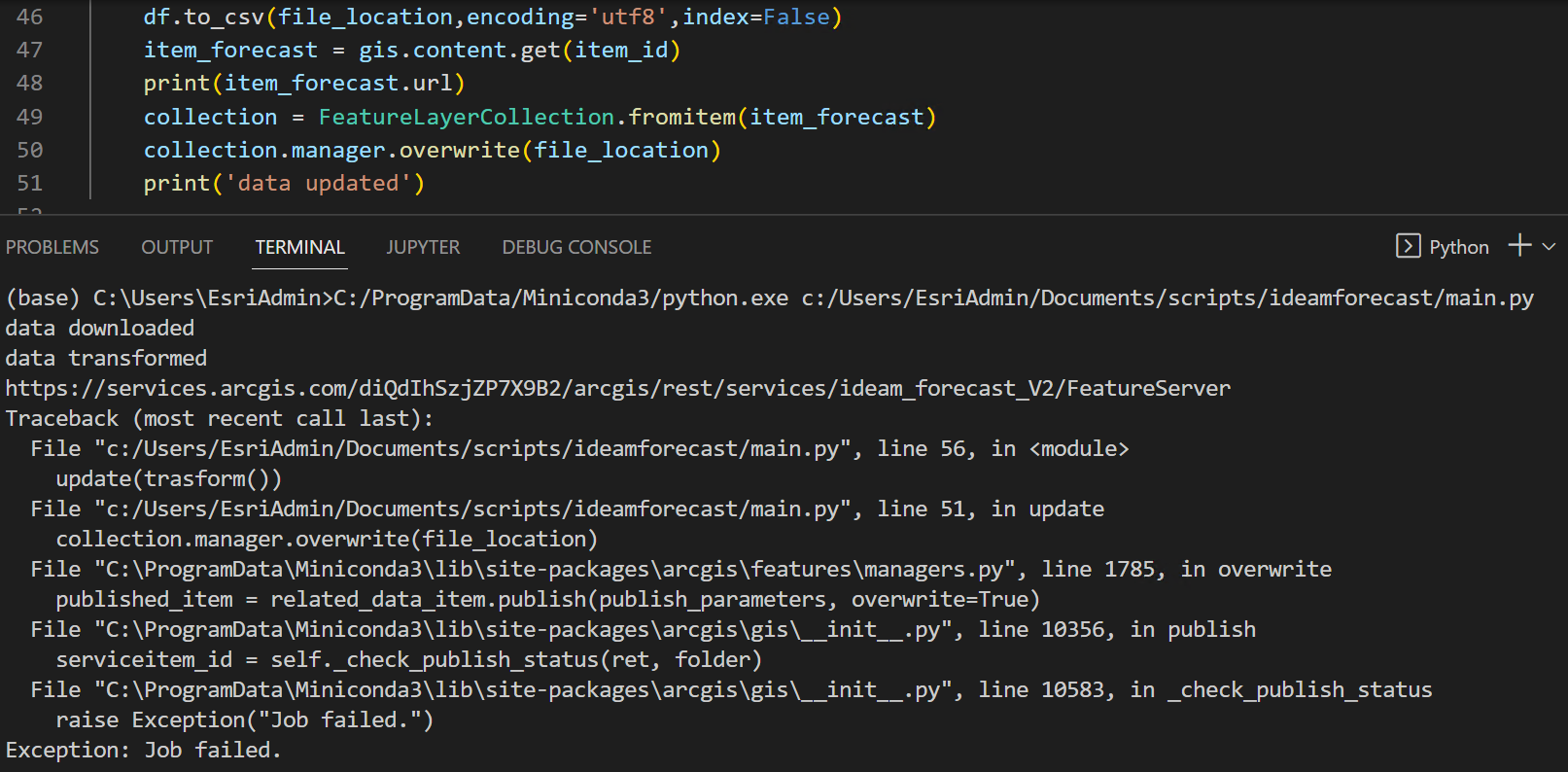

  1. This service has been overwritten automatically every 6 hours for approximately a year using a script. We process a CSV file, point to the item, and overwrite it using collection.manager.overwrite(csv), as shown in the image.
  2. Currently, when trying to overwrite the service, the following error appears:

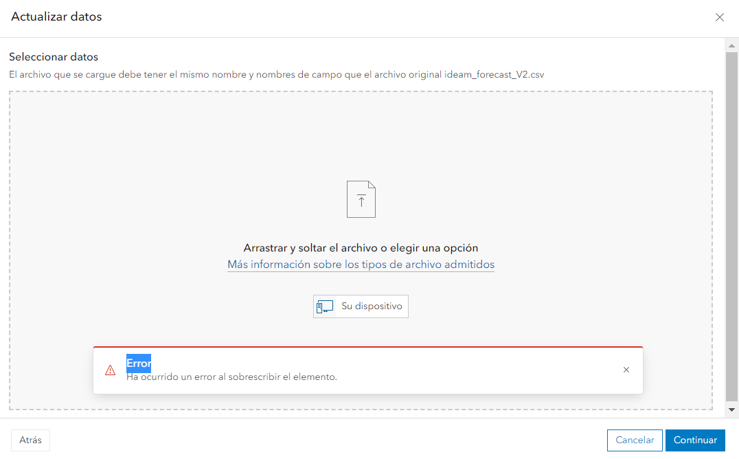

  3. We attempted to overwrite it manually from ArcGIS Online by directly uploading the CSV file, but the process keeps loading indefinitely without completing the action.

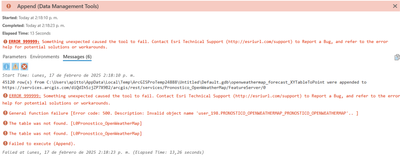

  5. We also tried using the Append tool by spatializing the table and attempting to add it to the existing layer, but we got the following result:
