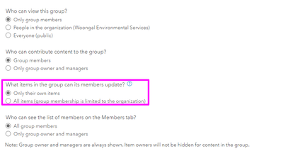

The default should allow it. I usually set group visibility to group members only. How are you setting the update tag? "All Items" is a confusingly worded setting that has broad ramifications. That has more to do with publication and maps & apps than editing simply put.
Use that for a group to allow multiple 'admins' to manage the maps & apps (but be careful to have too many cooks in the kitchen) and have a separate group with the setting as I've shown it for the editors.

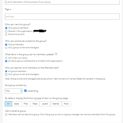

How do you set up those Editor groups? I only see from settings two options, its all about that setting that you have highlighted, isn't it? . If they can only edit their own items, that means is a "viewer" group (people can only view items shared within the group). The second option, all members will be able to edit other members items. In theory would be suited for an Editor license, but they are not allowed to join! How do you do it? Do you have a different setting structure for creation of groups?

Don't worry too much about the wording of the options for that setting. It is a bit misleading. You should be able to create the group with "edit their own items" and then add a few  Field Worker / editor users. Create a map with editable layers, publish to an app and share it with the group. The share process will ask to update the map and all the layers in it with the same group permissions.  The users should be able to see the app and edit objects and their attributes.  This is just a short description of the process. Are you across web maps, editing, etc?
