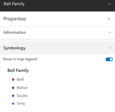

How can I add points the correspond to my new symbolized list?
I have been following this tutorial - https://youtu.be/zrlN7NrMawY?si=J21LuYz1rwv3-91F&t=1075
When I tried to digitize my map, to add points to my new feature layer,
I am able to add the points, but my 'List' field does not appear.

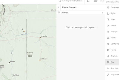

gertrudious
I don't think I explained my troubles well.
In this esri tutorial, at about min 2:31 (https://youtu.be/l2nhhOw7HW0?si=AR6yubg7ZTlY1nas&t=151)
the video shows how to add a point, from the field options that were created in the created feature layer.
when I attempt this step, to add a point to the map like in minute 2:31, I am not given the same option as in the video. Instead, I am given no option, like in my second photo from above.
I did not use a template so I am not sure what you are referring to. As well, I have seen several videos where what I am attempted is seemingly done with ease. Thus, I am guessing that your comment of "Managing templates within Map Viewer is on our future road map" may not actually fit my issue.
I hope I am explaining my trouble with a bit more clarity.
kind thanks.

EmilyGeo
Hi there,
I'm sorry you're still having trouble. In the screenshot that you shared, it says Click on the map to add a point. Are you able to click on the map to create a point? The fields should appear in the Editor pane after you place a point on the map.
If you are trying to access the list of templates, you can click the Back arrow.
