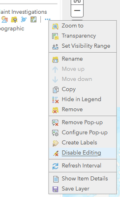

If the layer is already set to "editable", you can tell a specific map whether or not to allow editing in the map:

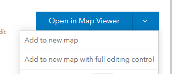

If the layer does not have editing enabled, you have to go to the Item page and toggle it in settings.
You can also open a layer that does not have editing enabled in "admin" mode. Or just stick &isAdmin=true at the end of the web map URL. But if you're not an admin, that probably won't work.
