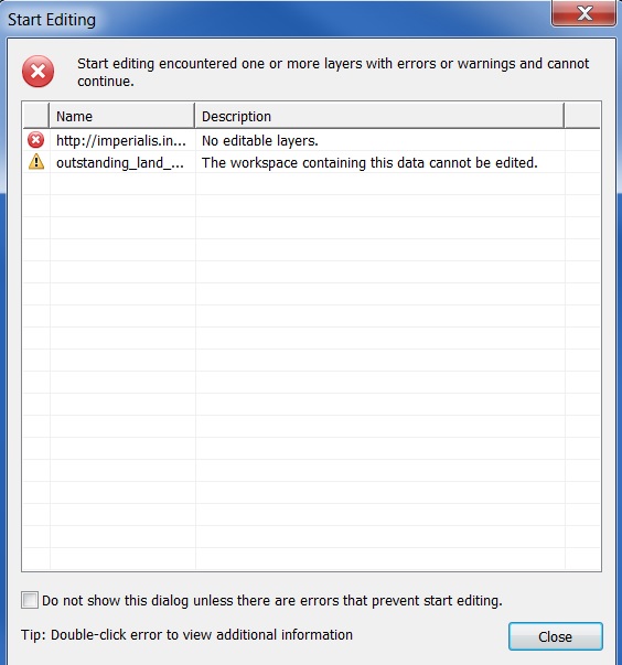

Jake,
I also received this message when I tried to edit the feature service by right-clicking -> start editing
