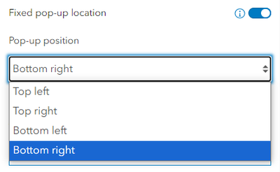

@RussRoberts Is it possible to change the popup location of a map using another app let's an Instant App template?
Question | Analyze | Visualize
RussRoberts
Esri Notable Contributor
You can adjust the docking placement in instant apps under the Step 2. About section.
Ed_
by MVP Regular Contributor
Cheers Russ, this helps 🙂
