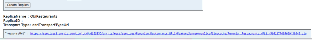

If all you have been given access to is the ArcGIS Services Directory for the parcel layer,  scroll to the bottom of the page and check if  you see a list that looks as follows:O6DeCEngtN.jpg
If you do, you should be able to use the Create Replica link to download the layer in Shapefile or other formats.
In the Create Replica form, you will need to provide:
Replica Name: <any_name>
Layers: (the layer number. If only one, enter 1)
Sync Model: (for shapefile, select "none" from the pulldown list.)
Data Format: (for shapefile, select "SHAPEFILE" from the pulldown list.)
Click the Create Replica button.
If successful, you should see a link at the bottom of the page (will have to scroll to the bottom of the page again) to the zip file that contains the shapefile. Click the link to download it.
