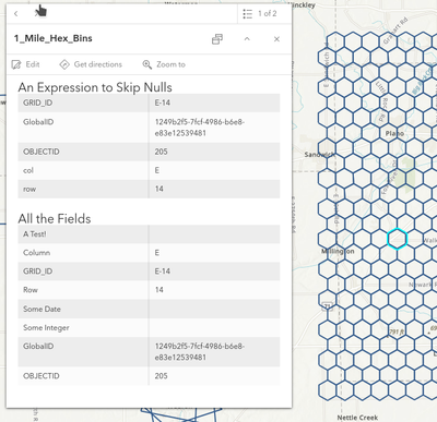

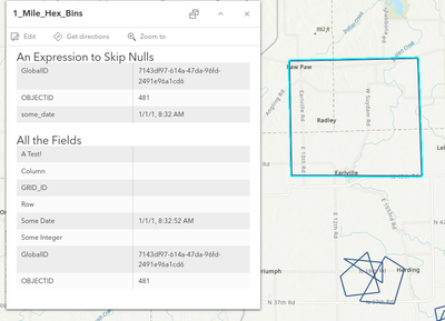

Here it is in action, with a regular fields list to show it working:
If you have certain fields you want to skip, you can code those in, too. It sounds like there are a lot of attributes you want to catch, so I don't know if it's going to be faster to grab *everything* and then remove ones you don't want, or to manually define the list of attributes you do want. But this should get you started.

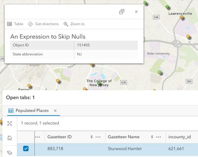

MDB_GIS
Does this still work for you? It does hide some fields, however the problem is that it hides fields that have data in it it as well. Here is a sample popup from our data:
Here is a screenshot of the selected feature's attribute table:
As you can see, there are several additional attributes that are populated, but are not shown in the popup.
