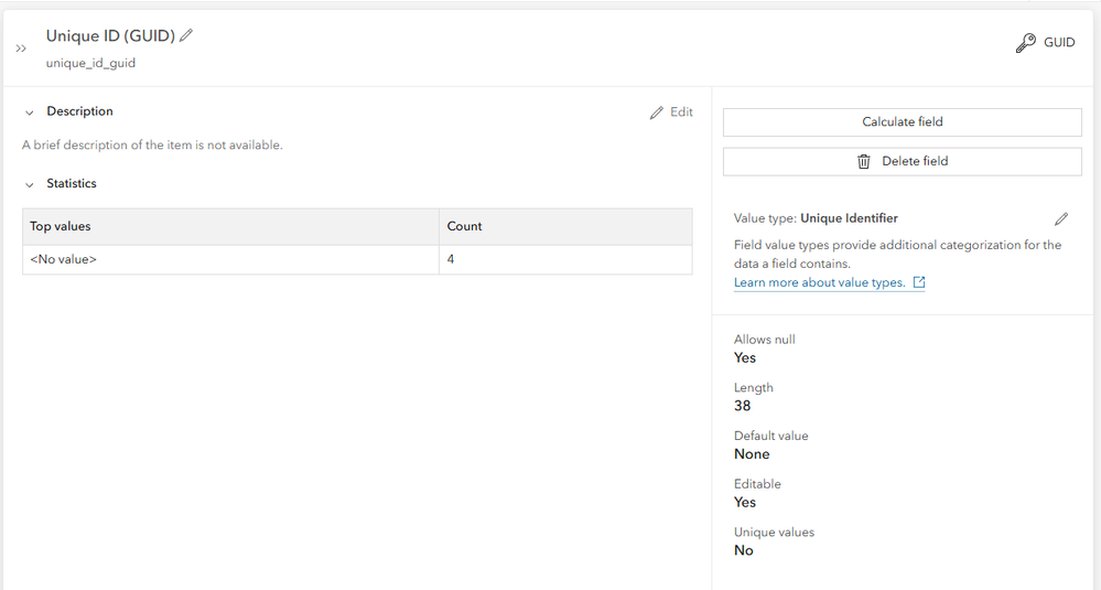

I need a custom auto-populated unique ID field, so I've added a GUID field using AGOL > Data > Fields. This is the resulting field:
Problem:
When I create new features in an Experience Builder app using the Editor widget, the new GUID field is not being populated. Why isn't it being populated?

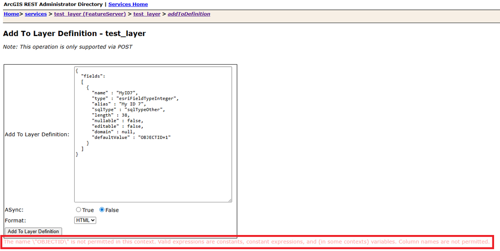

But when I tried OBJECTID+1, I got an error message:
  "fields":
      "name" : "MyID7",
      "type" : "esriFieldTypeInteger",
      "alias" : "My ID 7",
      "sqlType" : "sqlTypeOther",
      "length" : 38,
      "nullable" : false,
      "editable" : false,
      "domain" : null,
      "defaultValue" : "OBJECTID+1"
The name \"OBJECTID\" is not permitted in this context. Valid expressions are constants, constant expressions, and (in some contexts) variables. Column names are not permitted.
I googled the second sentence of that error message, and it appears to be a SQL Server message.
This message is a specific SQL Server error (Msg 128) that occurs when you attempt to use a column name in a database context where it is not allowed, such as within a DEFAULT constraint or during a data insertion where string quotes are missing.
Using Columns in Default Constraints: You cannot set a column's DEFAULT value to equal the value of another column in the same table.
https://share.google/aimode/tmot43yg8Iehd54KU
So I guess that's more evidence that we're dealing with SQL Server?
Additionally, I've seen some JSON examples online that have "defaultValue": "GetDate() WITH VALUES".  GetDate() appears to be a SQL Server thing too.

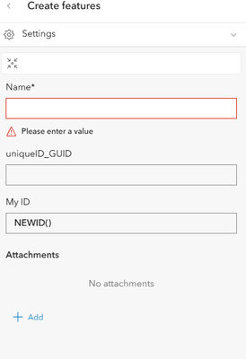

After creating the feature layer, I opened it in a web map and created a feature. At first I was worried because the interface looked like this:
But after submitting the form and checking the attribute table, the value was populated!!
I'm going to test further to see if I can get this integrated into the app I'm building, but this is huge. I really thought it wasn't possible to do this kind of thing and lots of research didn't turn up anything. Thanks again!
