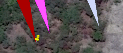

I've tried a few variations on this with rather odd results. The attached image shows these results. I'm working with both the vertices and polygons here for illustrative purposes. I'll describe the process for each one. Transformation A and B just represent different transformations rather than the actual transformations
Yellow point - original file in Arc 1950, no transformations set, layer to kml run
Red polygon - original file Arc 1950, output coordinate system set to WGS 84 and transformation set in tool environment settings.
Pink polygon - WGS 84, reprojected prior to running kml tool using transformation A
Blue polygon - WGS 84, reporjected prior to running kml tool using transformation B
So from this it would appear that using the environment settings of the tool does nothing. Reprojecting prior to running the tool results in a shift. How far that shift will be depends on the transformation used for which there appear to be no hard and fast rules.
Which one is correct and what should the workflow be when dealing with layer to kml and datums other than WGS84?
On top of that, using a basemap if I add the layers first (setting the dataframe to Arc 1950 from the first layer added) and then add a basemap, no warnings or errors are given. Presumably this will behave as the red polygon above did.
If I add the basemap and then the layers I'm asked to set the transformation. Granted there is a difference between the transformations but there is also a difference between the default behaviour (outlined above for adding the basemap after layers) and setting the transformation.
UPDATE
The layer to kml tool is defaulting to the first transformation (Arc1950 to WGS84 (1)) available. It does this when the source file is in Arc1950 and appears to over ride the tool environment settings.
The shift from one transformation to another can be as much as ~70m in this case depending on where the data is and so it would seem to be appropriate to reproject the data to WGS84 prior running kml to layer using the required transformation rather than relying on environment settings in the tool. Which I guess is what the docs say but I feel they could be more explicit as to what the default behaviour is.
