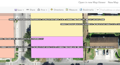

JorgeKappa
Same map, same label, same expression, works fine in new Map Viewer, not in Classic Viewer. I don't even see it in the list of functions.

JasonGlidewell
Works fine for me.  I find Classic Map Viewer easier to use.
TextFormatting.NewLine is under constants, not functions.

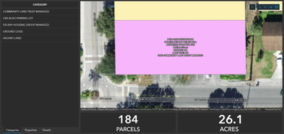

JorgeKappa
Check it:
I think it used to work, but it broke when I did this: the user wants to print from the dashboard. Told them dashboards don't print. They say make it print, so I made a WAB with the Print widget and embedded both the dashboard and the app in an Experience Builder. I thik that broke it. No biggie because I couldn't figure out how to transfer the selection in the dashboard map to the one in the webapp. I was going to make them search.

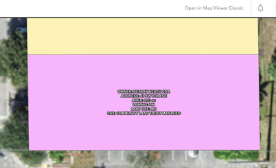

OK. I think I'll go with the standalone WAB with Print widget and add a custom search to allow replication of the selection in the dashboard, but in a map with labels off displaying the popup. Either that or take a screen capture. I have to look into the new dashboard, haven't  had the chance. I did notice you can make one in Experience Builder.
I must be inadvertently using the new ones because the labels do work:
