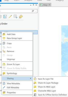

The documentation appears to discuss this but in my Pro after adding the AGOL hosted feature layer, I do not see the "Publish Layer From Feature Layer" command as indicated in this document. https://pro.arcgis.com/en/pro-app/latest/help/sharing/overview/publish-a-map-image-layer-from-a-host...  I did test creating a hosted tile layer from it, which worked but as expected the sublayers can't be turned off and for that and other reasons a tile layer would not work; it needs the classic map image layer dynamic map service. If there is anything else I can try I would appreciate any advice and thanks again!
