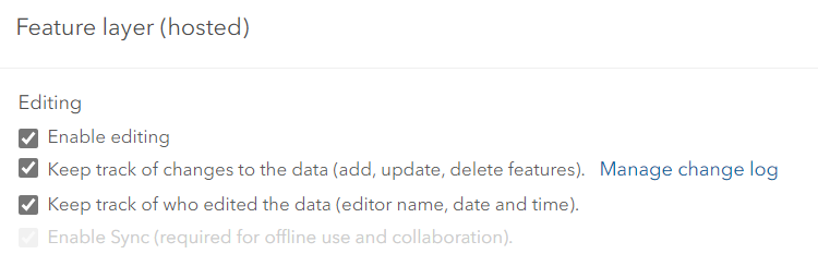

    • Other comments: This layers settings in ArcGIS Online is different compared to Sewer Systems feature layer. In Water Distribution system the “enable synchronization” is checked but its grayed out, which is not the case in Sewer System settings.

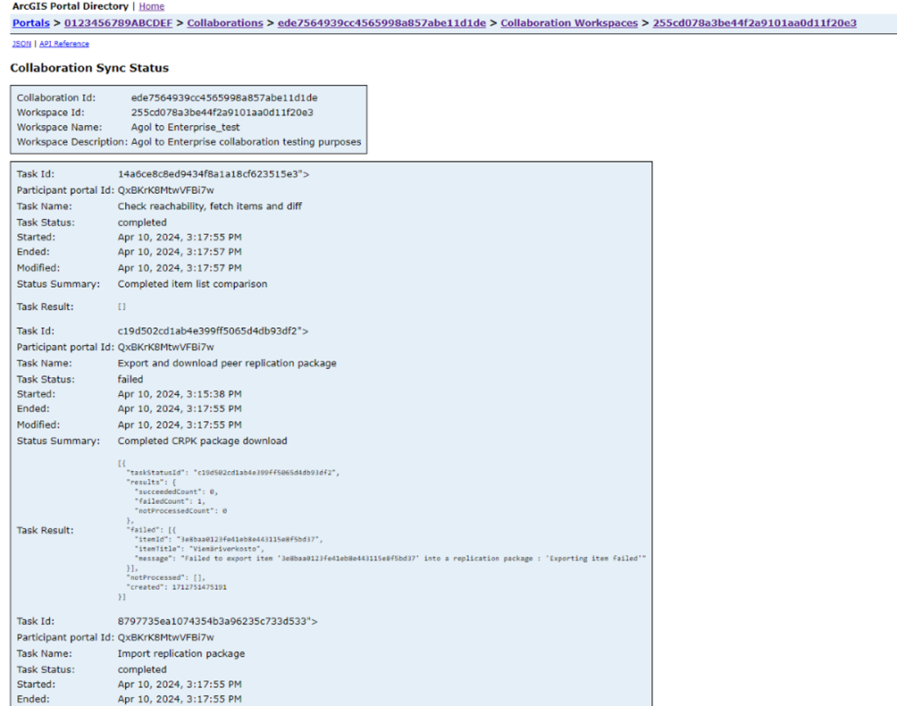

      Heres messages we managed to get:
