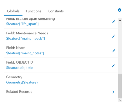

If you've not used the FeatureSetByRelationshipName function before and are unsure of the 'relationship name' parameter, not to worry. In the expression builder built into the map viewer, you can find it in Globals -> Feature -> Related Records (at the bottom of the fields list) -> Relationship
Just click the blue link under the relationship to insert it into your expression.
