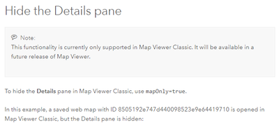

If I choose to embed the new map viewer product, it's lacking the mapOnly URL parameter.

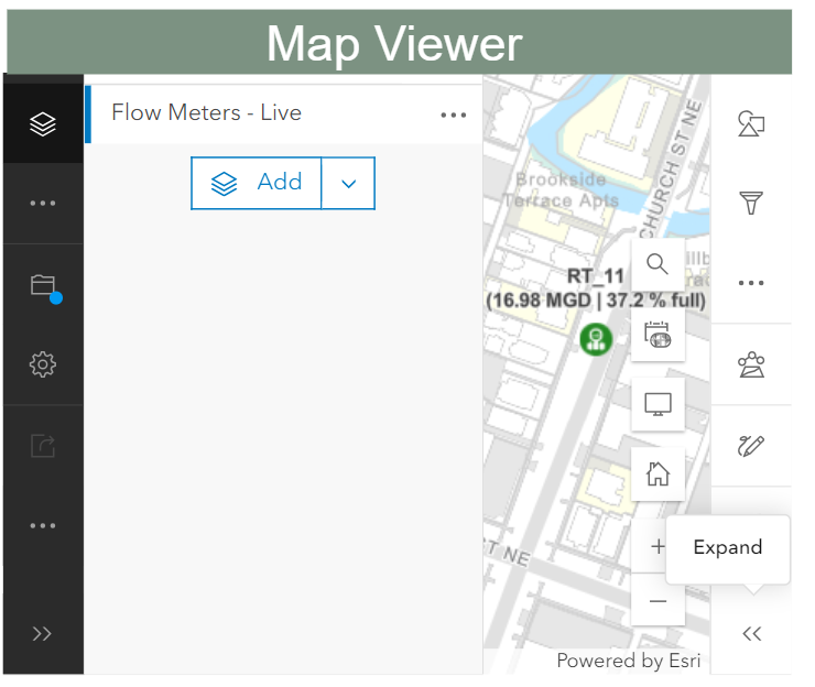

And if I can't hide the details and layers and all the junk that I don't want to see, then I'm left with all this junk opening like this:

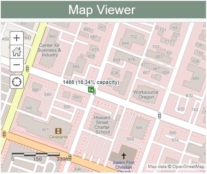

in comparison to the map viewer classic:
Wow, so clean on load!

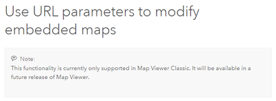

So you're probably going to suggest using the Embed URL parameters for webmaps...
It doesn't seem fully supported, as each way I try to construct an Embed parameterized URL to focus on a subset of layers I'd like to embed, it returns the original layer exposed when the webmap was published.
