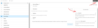

Do you have a screenshot of what fields you're trying to delete? For example, in this interface if I select any "normal" fields I see the trash can delete icon. However, if I select fields like OBJECTID or GlobalID, that icon isn't available.

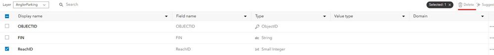

see below. both red arrows show spots where there Should be a delete button (and there is for other layers)
