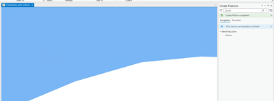

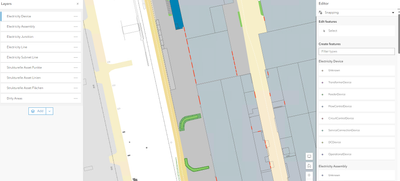

StefanAngerer
Hi Koen,
thanks for the initial help, though i still don't know if thats really true. I made a little testcase where I only made one feature template in the map which i have shared as webmap in agol. The map is called "CONSUMER_MAP_STROM" and has one template "HVLine". All the other templates were deleted by me. So in my understanding the webmap should only have that one feature template. Now jumping over the webmap. The EleLine Assetgroup indeed only has one feature template, however, all the other assetgroups have all the default templates even though I have deleted them. Why is this the case? What can I do that this is not happening?
Thanks, Stefan
Consumer-Map in ArcPro with one template:
Consumer-Map as WebMap in webmap viewer with multiple feature templates:
