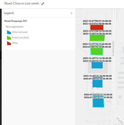

Thank you for the quick response @RPGIS it works almost perfectly. The only problem with it though is if the feature's start date is today or in the future it is symbolized as "Active last week".
Features with a start date today or in the future, and an end date of today or in future it is labeled as "Ended last week".
Is the limitation of the DateDiff function that it cannot tell the difference between positive and negative difference, and I should be using something else for this symbology?
The two highlighted examples show the symbology issue I described:
Thank you again.

Hi @brandonmann3,
You could set it to identify if the future date is greater than now which would solve your issue.
Add  now() < $feature.start_closure to the first if statement and now() < $feature.end_closure to the second if statement and that should work.
