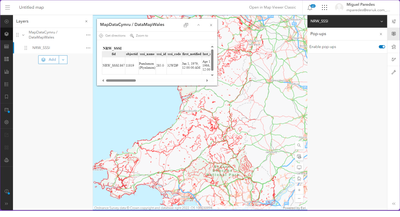

The WMS does work for me in MapViewer:
That was using the URL: datamap.gov.wales/capabilities/layer/386/?ows_service=wms
Can you give that another go and see if that works for you?
