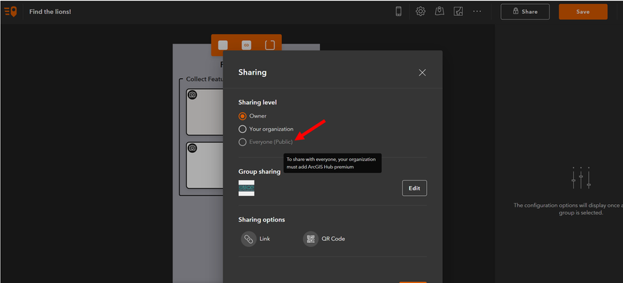

Thank you for your reply! I'll definitely look into this - but just a quick note about the QuickCapture -
I'm wondering if this might be a recent change! When I try to share a QuickCapture project publicly - the button is grayed out and it says "To share with everyone, your organization must add ArcGIS Hub premium"
Is this something I could contact support about? If QuickCapture is not related to ArcGIS Hub, I'm wondering if we might have a bug in our organization instance.
Any thoughts? Thank you again for the help!

Richard_Purkis
Hi @SaraJL
Thanks for bringing that to my attention. That is news to me too but I have just confirmed with the documentation that is expected.
For your needs though I do not believe it would be required to share the Project publicly. You will want to share at an organizational level
Let  me know if you have any more questions.
