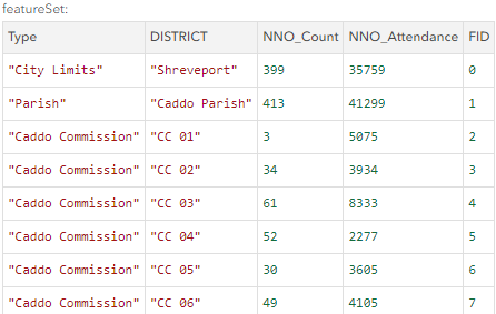

I originally created a data expression that intersected a point layer with a polygon layer and returned a count of points per polygon and a sum of a field.

Now I've been asked to split each of the counts and sums for each district by Survey_Year. I lost count of how many iterations I did on the above code but could never figure it out. I am now trying to use this code to accomplish my goal but I can't seem to figure it out, if I'm even going in the right direction.
