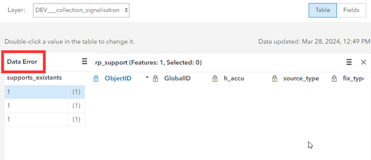

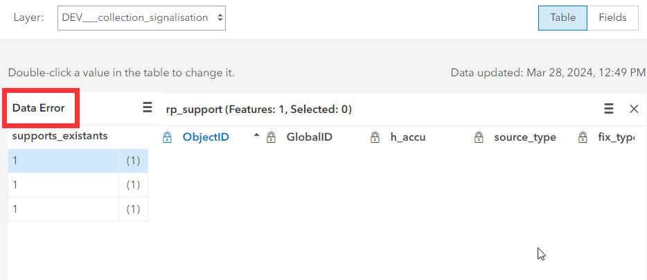

When I click on the "Show" link from my main layer to check related records, I get a "Data Error" on the top left corner and no records show.

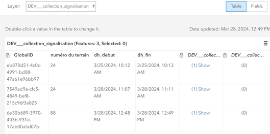

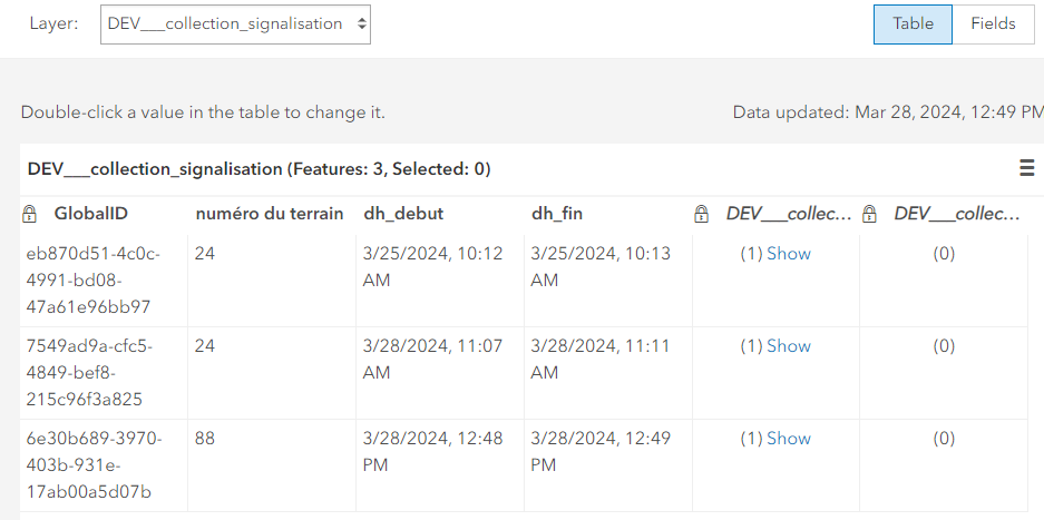

I hids some columns in the following screenshots to see the globalid columns and relations.

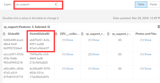

But if I select the related table on top, I see that the data is there:
And if I click on any relation from those records (parent or child), I also get a "Data Error".

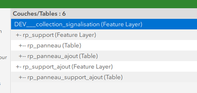

Here is my structure:
