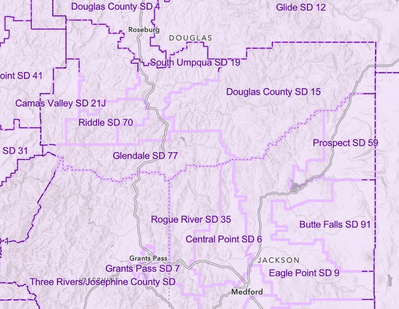

I published a hosted feature service from ArcGIS Pro. When I view the layer in the ArcGIS Online Map Viewer the dashed part of the polygon outline keeps disappearing when I zoom in and out. Is there anything I can do to get my symbology to consistently appear?

@RussRoberts Thanks! I just added your russell_jsapi account to a group. Once you accept the invite you should be able to see this feature service https://www.arcgis.com/home/item.html?id=05c37c7695c94c06b222431b61768d0b If you go to the visualization tab of the item details page and zoom in on the Douglas County area in south western Oregon I'm able to pretty consistently see the problem shown in the screenshot.

The video seems to focus on problems caused by dash patterns overlapping. I have a solid dashed stroke which is on top of a solid stroke for each polygon. This resolves the issue of dash patterns intersecting with each other in Pro (though I'm not convinced it's working as well in Online) and also helps with accessibility.
The issue I'm most concerned about is when I zoom in to certain areas of the map (only in Online) the dashed stroke disappears completely.

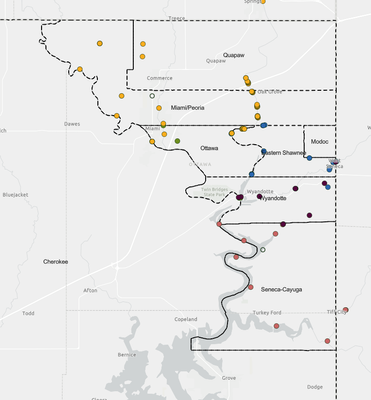

@RussRoberts I am experiencing the same issue as @ArielLow2146. I'm mostly seeing the dashed polygon outline turn into a solid line (see below) rather than disappear completely, but this consistency also seems confusing for users. Would be interested in any update of this getting fixed.
