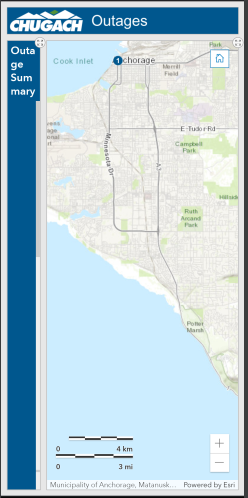

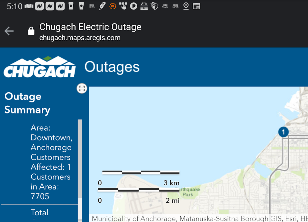

Is there a why to force the dashboard to load in landscape? Or is there a way to make my list view auto hide when in portrait? I tried to add my list elements to the side panel but it does not appear to support imbedding other elements.... ?  in short I need a why to make this look okay.....
land scape is a lot better but still not great on the phone.
Unfortunately, both of these options are not available with ArcGIS Dashboards at this time. Sorry. Please review this help topic: Dashboards on your smartphone.
FYI, the ArcGIS Dashboards Dev team is actively working on enhancing the mobile user experience for dashboards in future releases. If you have specific requirements, please let us know.
